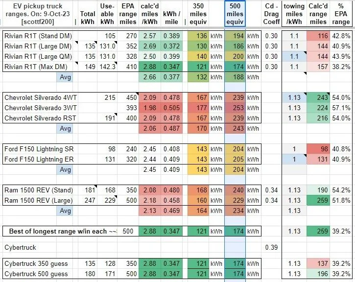

So feasibly a full double layer under the entire cab could be around 200 kWh and it would need to be very efficient to hit 500 miles with that pack. I think the average tends to be closer to 2 miles per kWh.
Where did you get that 2 miles per kWh? The Ford and Rivian are quite a bit higher than that (spreadsheet above).
I live in a state that gets 4 season. My average over the 10k miles is 2.5 with my Lightning

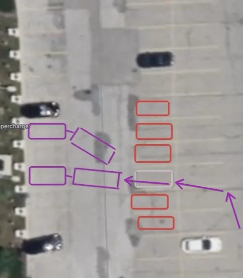

I think the "X factor" that makes the Cybertruck different is towing range. All of Teslas other cars don't have this as a competitive thing with other companies. It is a comparison that will be made regularly and in most articles when the CT comes out.
The Superchargers every where aspect does pan out in my head because 99% of the supercharger site do not have pull-thru. I do*not count the sometimes pull in (vs back in) stall as a towing spot because 95% of the supercharges with that would have a trailer blocking the lane.
Below is not the exact same as the pull-in spot but still exemplifies that the parking lots often have lanes and other parking spots right next to the supercharging area.
Tesla Cybertruck More 500-mile range rumors! Screenshot of Silverado EV tows over 230 miles! _ Page 2 _ Tesla Cybertruck Forum - News, Dis
Screenshot of Silverado EV tows over 230 miles! _ Page 2 _ Tesla Cybertruck Forum - News, Disc...jpg
